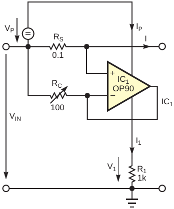

This circuit uses the negative-supply current of the op amp to measure the high-side supply current

Simple circuit provides high-side current sensing
Figure 1. This method for measuring high-side supply current requires an auxiliary transistor
Figure 2. This circuit uses the negative-supply current of the op amp to measure the high-side supply current
Figure 3. Because of the positive-supply current, the measured values (dots) do not agree well with the theoretical values (straight line)
Figure 4. Gain compensation by adjusting R
C
improves the accuracy of the measurement
