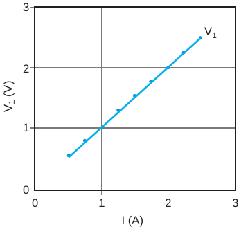

Figure 3. Because of the positive-supply current, the measured values (dots) do not agree well with the theoretical values (straight line)
Figure 4. Gain compensation by adjusting R
C
improves the accuracy of the measurement
