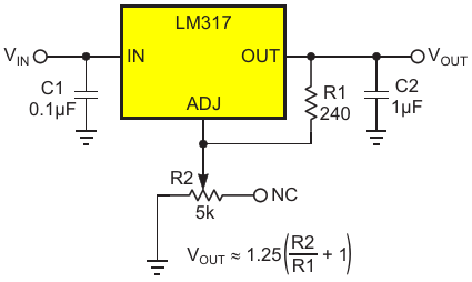

The typical regulator datasheet …
The typical regulator datasheet adjustment circuit
Stephen Woodward
Adjustable regulator trimmer simple failsafe circuit
Figure 1
12 Kb
Figure 1. The typical regulator datasheet adjustment circuit
Figure 2. A simple failsafe circuit where the NC pin of the pot R2 (in Figure 1) is instead connected to Q1
