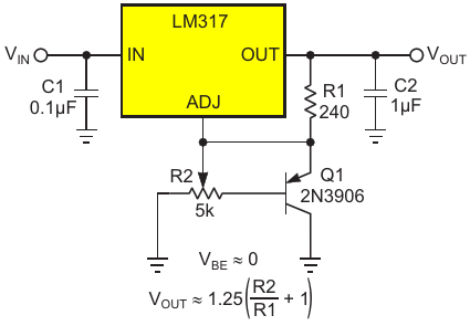

A simple failsafe circuit …
A simple failsafe circuit where the NC pin of the pot R2 (in Figure 1) is instead connected to Q1

Adjustable regulator trimmer simple failsafe circuit
Figure 1. The typical regulator datasheet adjustment circuit
Figure 2. A simple failsafe circuit where the NC pin of the pot R2 (in Figure 1) is instead connected to Q1
Figure 3. Failure is an option!
Figure 4. Failsafe circuits with a negative regulator need an NPN Q1
Figure 5. Failsafe circuit with the pot wiper grounded
