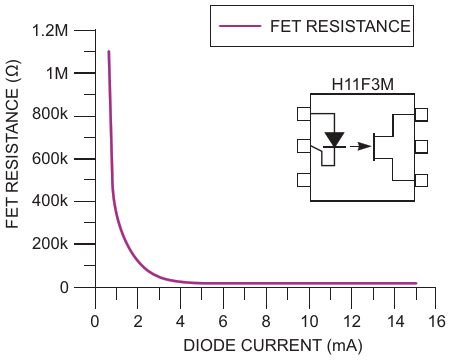

The output resistance of a photoelectric FET is nonlinear with respect to the input-LED current

Use a photoelectric-FET optocoupler as a linear voltage-controlled potentiometer
Figure 1
Figure 1. The output resistance of a photoelectric FET is nonlinear with respect to the input-LED current
