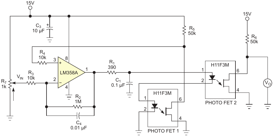

This circuit feeds back the response of an identical photoelectric FET to linearize the response
Sajjad Haidar
Use a photoelectric-FET optocoupler as a linear voltage-controlled potentiometer
Figure 2
13 Kb
Figure 1. The output resistance of a photoelectric FET is nonlinear with respect to the input-LED current
Figure 2. This circuit feeds back the response of an identical photoelectric FET to linearize the response
Figure 3. The feedback circuit greatly improves output linearity
