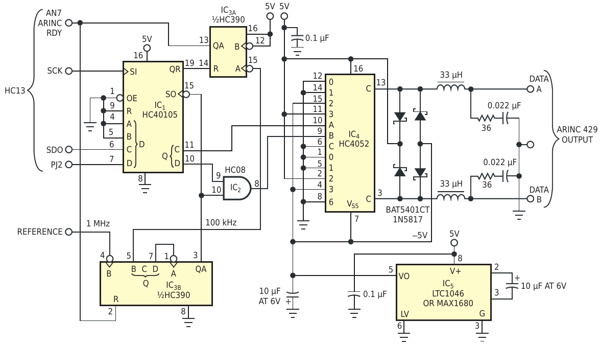

This ARINC 429 transmitter operates from a single 5 V supply and meets all timing requirements of the 429 spec

Circuit transmits ARINC 429 data
Figure 1
Figure 1. This ARINC 429 transmitter operates from a single 5 V supply and meets all timing requirements of the 429 spec
Figure 2. The ARINC spec imposes rigid requirements on waveforms
