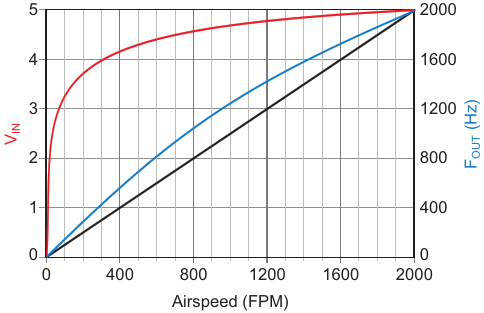

Figure 2. V
OUT
versus airspeed response of thermal sensor is very nonlinear
Figure 3. Anti-log linearizing VFC
Figure 4. Airspeed response linearity of Figure 3's anti-log VFC is better but still un-terrific
