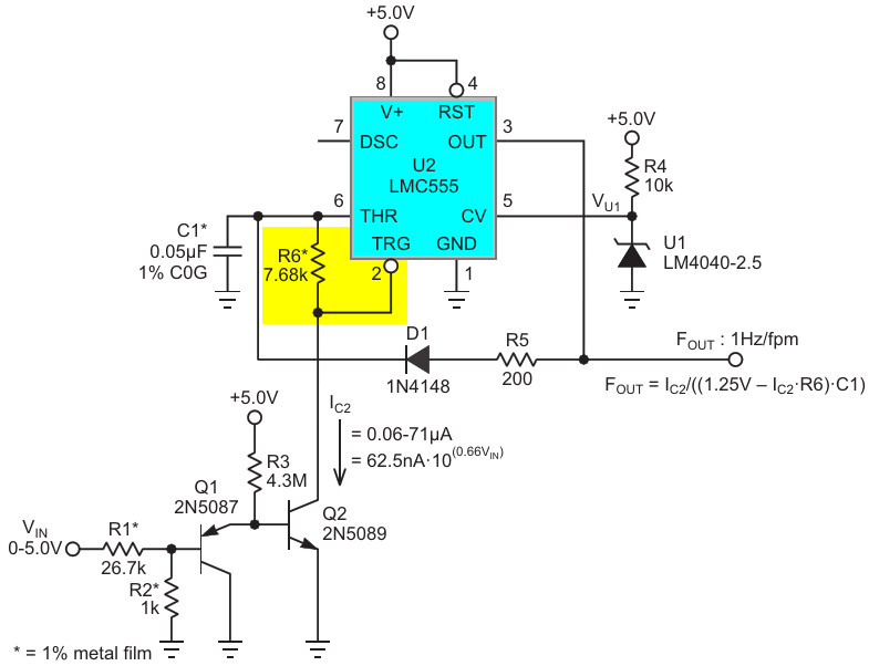

Adding one resistor (R6) and adjusting another (R1) ironed out the bump in Figure 3's analog linearizing

Figure 3. Anti-log linearizing VFC
Figure 4. Airspeed response linearity of Figure 3's anti-log VFC is better but still un-terrific
Figure 5. Adding one resistor (R6) and adjusting another (R1) ironed out the bump in Figure 3's analog linearizing
