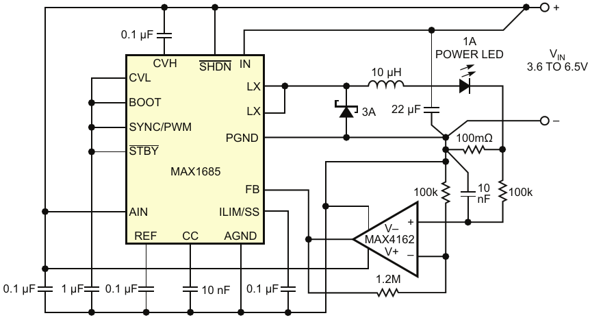

This miniature, 1 A, high-power LED driver operates on 3.6 to 6.5 V

Figure 1. This miniature, 1 A, high-power LED driver operates on 3.6 to 6.5 V
