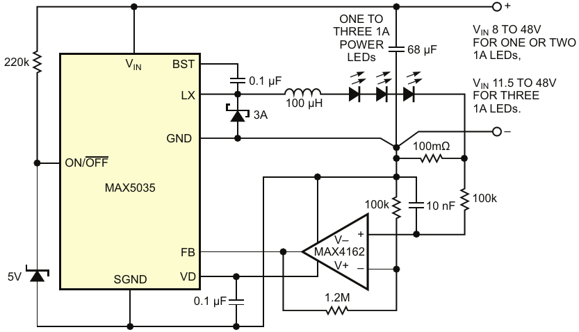

This miniature, 1 A, LED-driver circuit operates on 8 to 50 V and drives as many as three LEDs in series

Figure 4. This miniature, 1 A, LED-driver circuit operates on 8 to 50 V and drives as many as three LEDs in series
