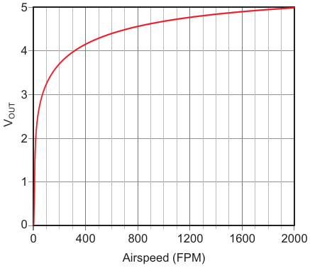

versus airspeed …
The V
OUT
versus airspeed response of the thermal sensor is very nonlinear

15-bit voltage-to-time ADC for "Proper Function" anemometer linearization
Figure 1. The V
OUT
