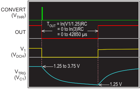

ADC cycle begins with …
ADC cycle begins with a CONVERT THR pulse that generates an OUT pulse of duration T
OUT

Figure 3. ADC cycle begins with a CONVERT THR pulse that generates an OUT pulse of duration T
OUT
= ln(V
1
/1.25 V)R1C1
