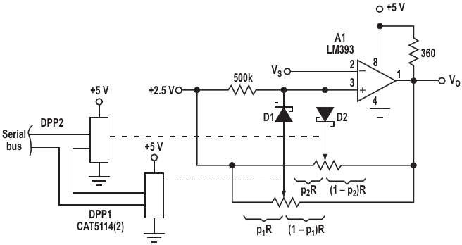

Adding steering diodes D1 and D2, plus another potentiometer, allows independent programming of the upper and lower hysteresis limits

Figure 3. Adding steering diodes D1 and D2, plus another potentiometer, allows independent programming of the upper and lower hysteresis limits
