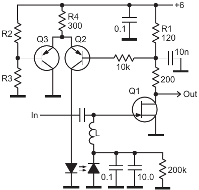

A control loop that …
A control loop that produces control voltage of negative polarity for n-channel JFET amplifier in HF and UHF applications

Figure 1. JFETs typically require some reverse bias across the gate terminal and in HF/UHF applications, this is often provided using the voltage across resistor R
S
Figure 2. A control loop that produces control voltage of negative polarity for n-channel JFET amplifier in HF and UHF applications
