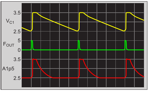

VFC oscillation waveshapes where: …
VFC oscillation waveshapes where: VC1 is the VFC timing ramp, F
OUT
is the output to counter, and A1p5 is the comparator's non- inverting input

Figure 2. VFC oscillation waveshapes where: VC1 is the VFC timing ramp, F
OUT
