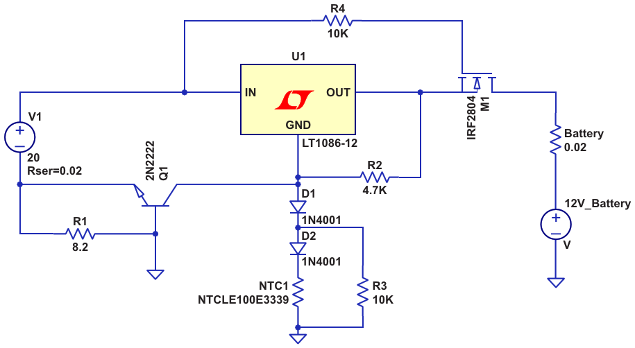

The design provides constant …
The design provides constant charge current and temperature compensated float voltage with a small number of common components
Dave Conrad
Temperature compensated lead acid battery float charger
Figure 1
17 Kb
Figure 1. The design provides constant charge current and temperature compensated float voltage with a small number of common components
