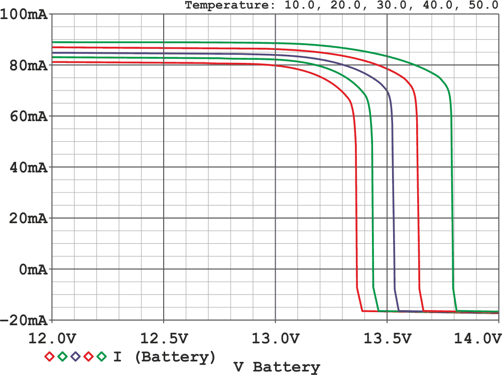

As can be seen from Figure 2 the battery voltage will float at a current somewhere between the knee and 0 A. This would be the current needed to maintain the float voltage at a particular battery temperature. Red to green traces depict operation at temperatures of 50 to 10 °C in 10 °C intervals.
Battery operation at temperatures of 50 to 10 °C.
Figure 2. Battery operation at temperatures of 50 to 10 °C.
