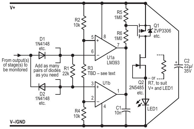

The diodes combine the …
The diodes combine the signals to be monitored, and the comparators check if any of them is close to your chosen limit, either negative or positive. If so, the LED flashes
Nick Cornford
Visual overload alert
