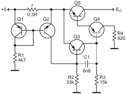

The Q1, Q2 transistor …
The Q1, Q2 transistor pair provide thermal compensated monitoring of the voltage drop on resistor r; when this drop rises to ~20 mV, the fuse goes "on", limiting output current to ~150 mA
Peter Demchenko
An accurate resettable fuse
Figure 1
