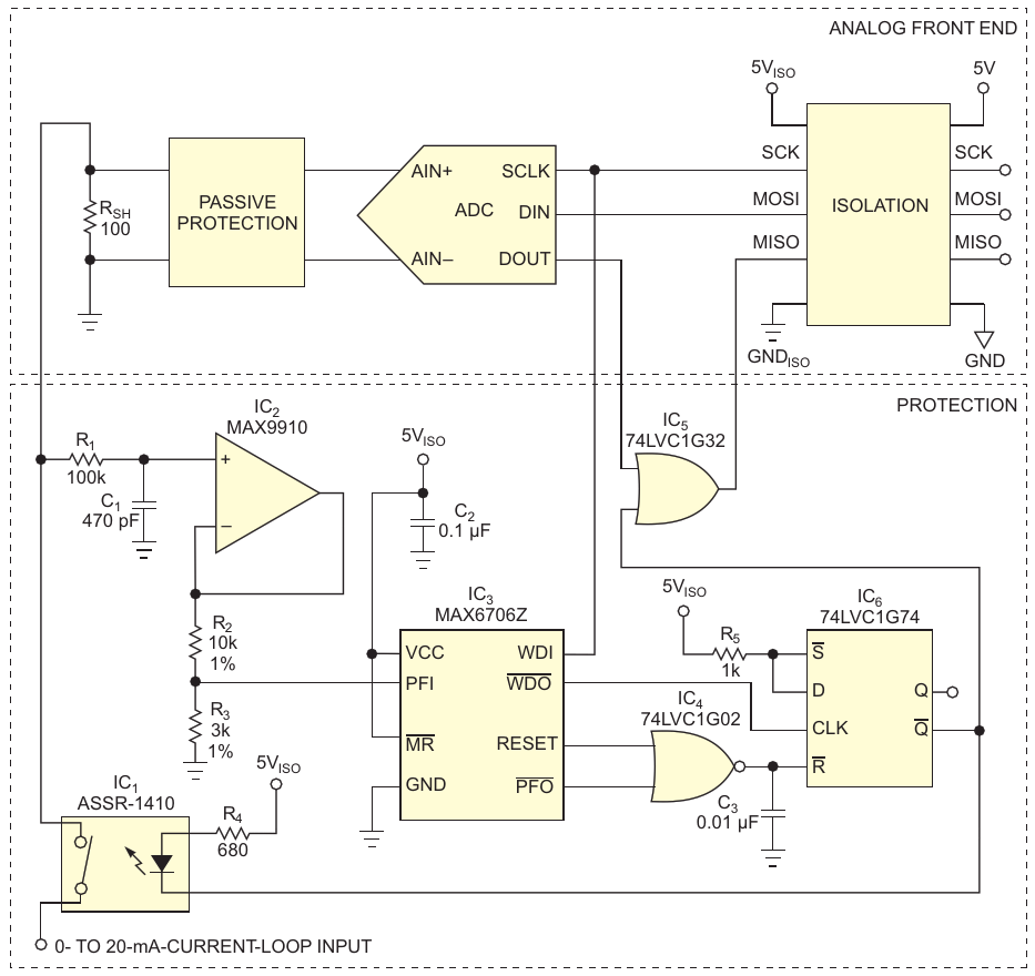

This circuit protects the …
This circuit protects the isolated analog front end of a current loop. For simplicity, the drawing omits power and ground connections for IC
2
, IC
4
, IC
5
, and IC
6
Anatoly Andrusevich
Microcontroller supervises 0- to 20-mA protection circuit
