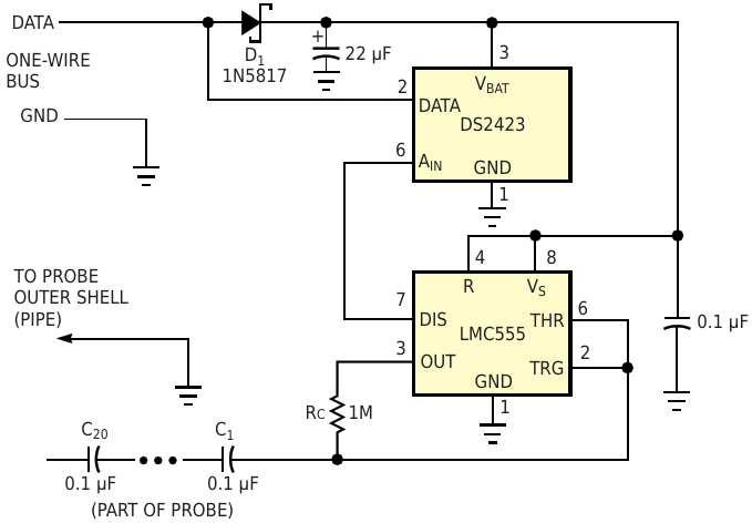

A simple 555-type timer …
A simple 555-type timer and a counter form the heart of a water-level sensor
Dale Litwhiler
One-wire bus powers water-level sensor
Figure 1
13 Kb
Figure 1. A simple 555-type timer and a counter form the heart of a water-level sensor
Figure 2. A string of series-connected capacitors provides an indication of water level
