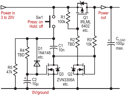

Two transistors form a …
Two transistors form a power-switching latch, which can be set (power on) by a short button-press and then reset (power off) by a longer one

To press on or hold off? This does both
Figure 1. Two transistors form a power-switching latch, which can be set (power on) by a short button-press and then reset (power off) by a longer one
