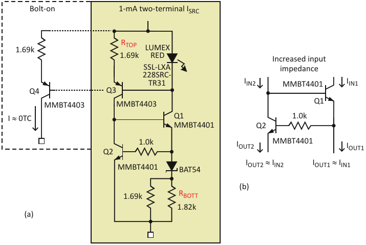

In the circuit for the 1 mA two-terminal current source, the leftmost PNP transistor (Q4) is a "bolt-on" to harvest the approximately 0 temperature-coefficient current in the left leg (a). The "glue" circuit allows the top current source to be m

In the circuit for the 1 mA two-terminal current source, the leftmost PNP transistor (Q4) is a bolt-on to harvest the approximately 0 temperature-coefficient current in the left leg (a) The glue circuit allows the top current source to be m
