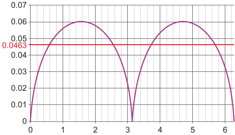

PTAT log(|sin(r)|) °K/5050 waveform. (Yaxis = volts, Xaxis = radians Red = average value = AC baseline)
