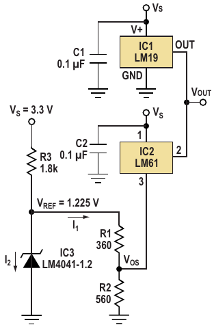

This dual-slope temperature sensor circuit can help compensate for the frequency drift of XT-cut crystals

Temperature-sensor circuit provides dual-slope output
Figure 1. This dual-slope temperature sensor circuit can help compensate for the frequency drift of XT-cut crystals
Figure 2. The outputs of two individual temperature sensors are superimposed to create an overall response that allows compensation for both negative and positive temperature coefficients
Figure 3. The measured V
OUT
demonstrates the V-shaped curve used to approximate the actual parabolic curve of XT crystals
