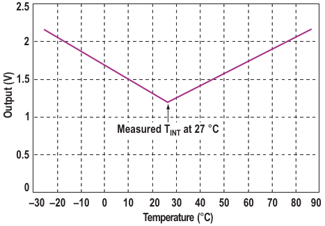

demonstrates the V-shaped curve used to approximate the actual parabolic curve of XT crystals

Figure 3. The measured V
OUT
