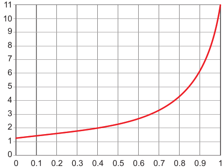

(1.25 V to 11 V) versus PWM D (0 to 1) where V
OUT
= 1.25 / (1 - 0.885×D)

Figure 1. LM317 regulator melds with HC4053 CMOS switch to make a 16-W PWM power DAC
Figure 2. The V
OUT
OUT
