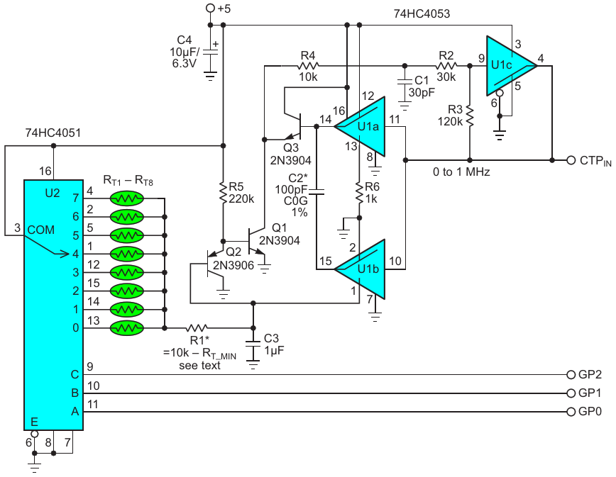

Capture 16-bit readings of 8 thermistors in less than 1 second for $2

Figure 3. Eight thermistors can share a single excitation resistor
