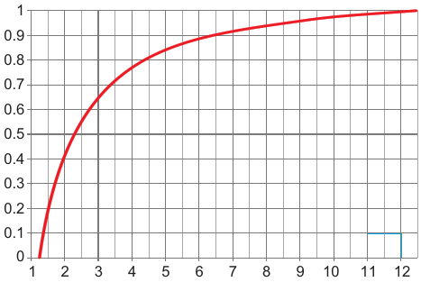

Figure 3. The inverse of Figure 2 or, the PWM D required for any given V
OUT
, where PWM D = (1.111 - 1.389/V
OUT
