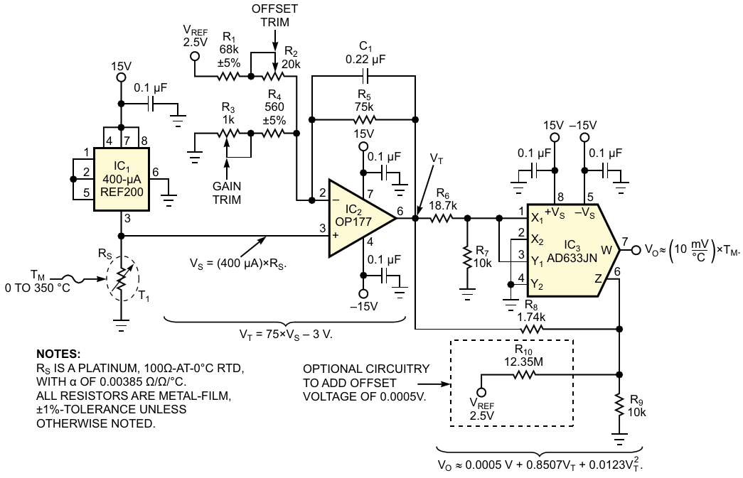

This RTD circuit uses …
This RTD circuit uses a second-order polynomial to linearize the output of the sensor
Robert S. Villanucci
Design an RTD interface with a spreadsheet
