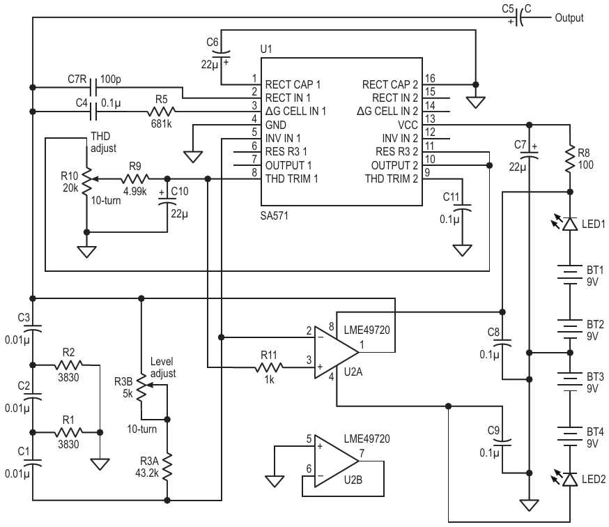

A simple, purely analog -130dB THD sine wave generator
Christopher Paul
A simple, purely analog -130 dB THD sine wave generator
Figure 1
18 Kb
Figure 1. A simple, purely analog -130dB THD sine wave generator
Figure 2. Responses of the dual-T notch filter. To simulate practical variances from the ideal, capacitor values were randomly selected to be within 1% of 10 nF, and R1 and R2 to be within 0.1% of ideal values for a 2400-Hz F
