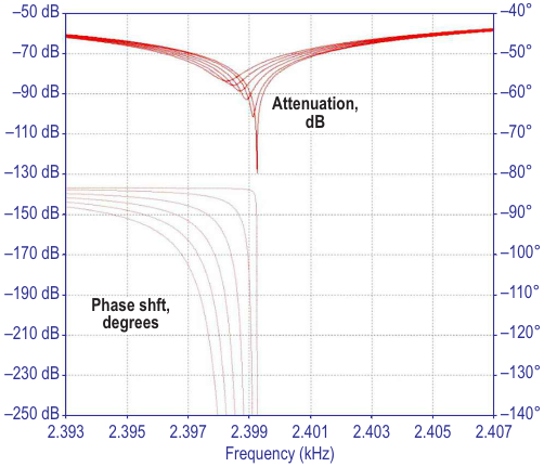

Responses of the dual-T notch filter. To simulate practical variances from the ideal, capacitor values were randomly selected to be within 1% of 10 nF, and R1 and R2 to be within 0.1% of ideal values for a 2400-Hz FOSC. A value of R3 that produ

Responses of the dual-T notch filter To simulate practical variances from the ideal, capacitor values were randomly selected to be within 1% of 10 nF, and R1 and R2 to be within 0.1% of ideal values for a 2400-Hz F sub OSC /sub  A value of R3 that produ
