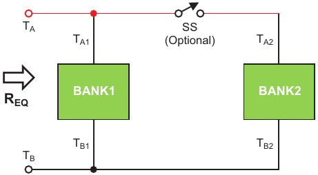

Versatile multistep resistor load bank is simple and modular
Figure 1. The load-resistor bank topology with four switches and five resistors is straightforward
Figure 4. The parallel connection of two load banks enables an increased number of steps for R
EQ
Figure 5. The variation in R
EQ
with BANK1 (R = 1000 Ω) and BANK2 (R = 910 Ω) resistors (with SS), with the step number sequenced for obtaining monotonically decreasing resistance values
