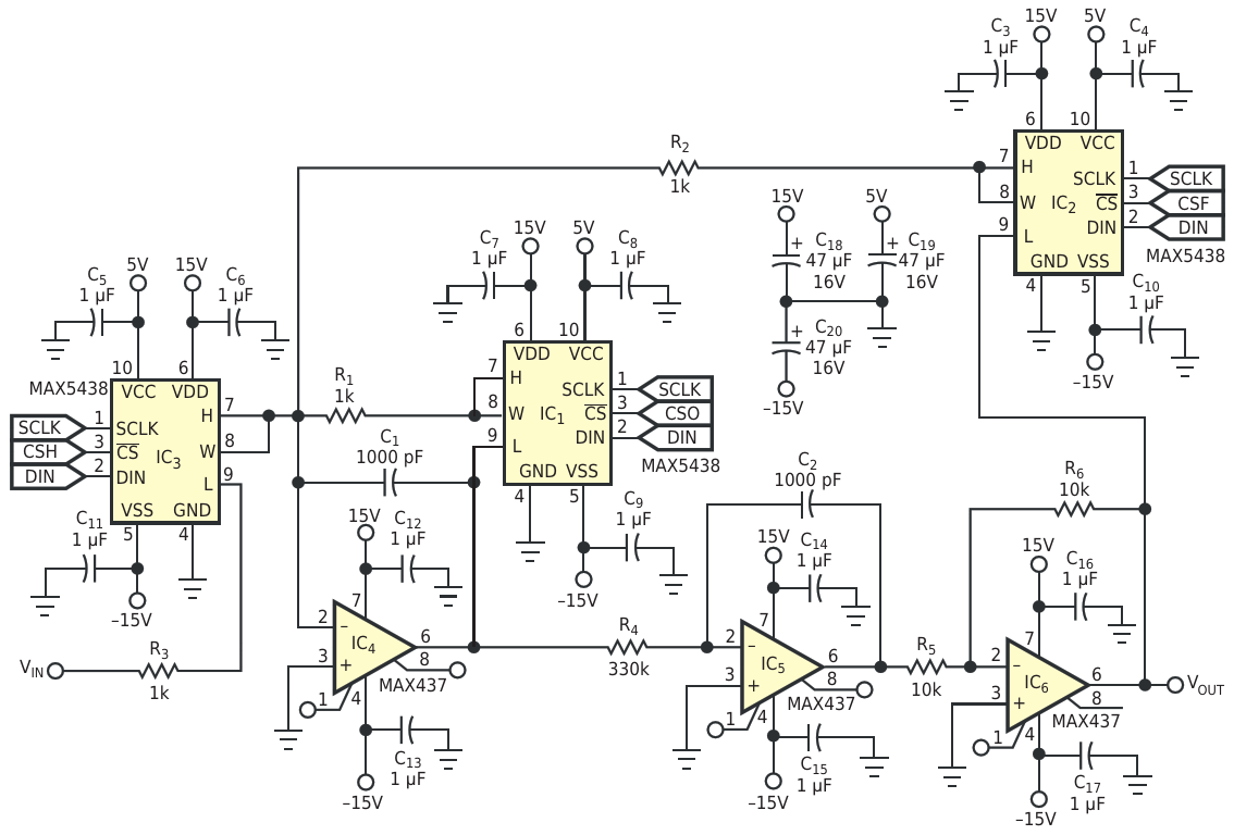

Digital potentiometers adjust the corner frequency, Q, and gain for this biquad analog filter

Figure 1. Digital potentiometers adjust the corner frequency, Q, and gain for this biquad analog filter
