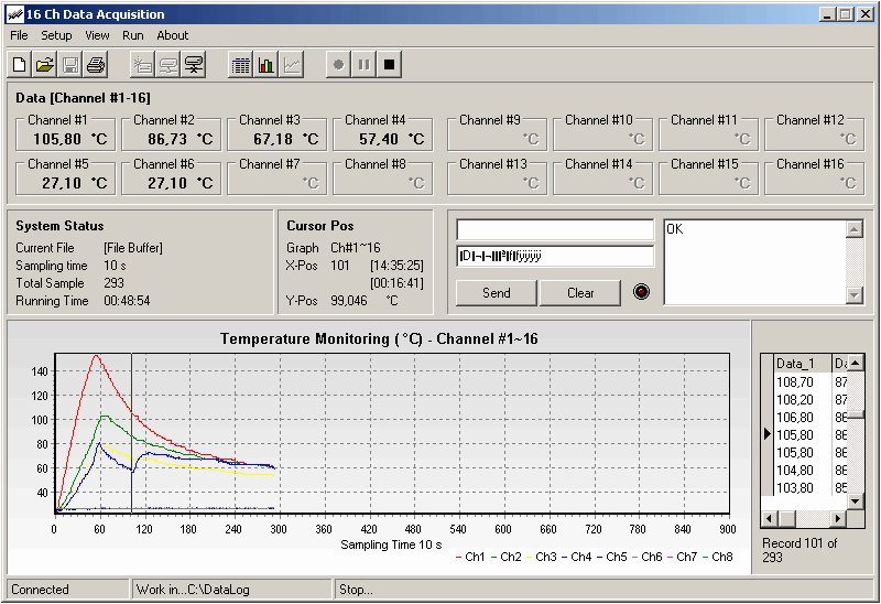

Software
Features of the software are as follows.
  • Adjustable sampling interval,
  • Real time view in single graph or multiple graph,
  • Record the data, save, and open the recorded database,
  • Get statistically reading, print the record and graph (or export it as the metafile, JPG),
  • Serial control window for monitoring and manually data transfer.
The full version PC software is designed for capturing up to 16 channels. In this version, the PC software will read 8 channels. For the ATmega8 in DIP version, it can display only 6 channels.
Figure 2. Main screen of Data Acquisition program

For real time recording using fast sampling, for example 50ms or 100ms, better view in a single graph. The display performance depends on the PC speed.
I tested running with 700MHz CPU speed, 128MB RAM, it gives smooth view but for multiple view, it could not display fast enough.

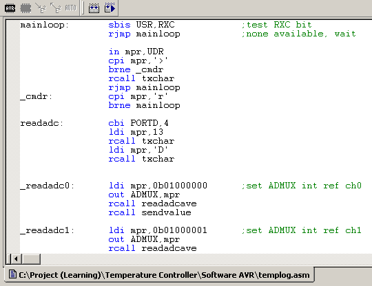

Microcontroller Program
The AVR program was written in assembly language. The main code running waits the serial command from PC. The speed is set to19200 8n1 format. If the board receives character '>', the AVR must echo the character '>' to the PC. This step is used to check the hardware is connected or not. Another command is 'r' (read), the microcontroller reads 8 channel ADC and sends them to PC serially.
Figure 3. ATmega8 Assembly code.
If you have only 6 channel, for last channel (ADC6 and ADC7), you can modify the source code so the microcontroller will send a dummy value. These values will be ignored by PC software. Or if you want to ignore another channel from PC logging, just fill ADC values with dummy into their field. The descriptions have been commented in the source code. You may modify the source code easily.
