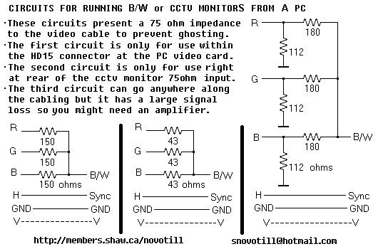

RGB to Monochrome Converter. Matches Impedance of PC to CCTV Monitor
Often you can get away with running a monochrome monitor on GREEN, but this looks real crappy when viewing color images. These simple resistor networks allow you to display R+G+B on a B/W or CCTV monitor without ghosting. Be shure to set your video card for 60Hz interlaced. Most video cards do give you Csync out on H. You can also run an OLD monochrome EGA or VGA monitor like this, but be shure to hook up the Vsync. This will not work on TTL monitors. Note that some monitors require unusual sync polarities!
Rgb To Monochrome converter - Matches impedance of PC to CCTV monitor
