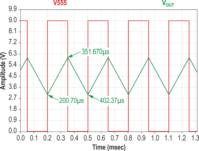

Assuming that the circuit has reached steady-state, then the working principle is as follows: When the voltage across capacitor is 1/3VCC, the 555’s output will be high, making D1 and D4 reverse biased but D2 and D3 forward biased. Therefore the capacitor will charge through D2 with a constant current I1 (its voltage will increase linearly) until its voltage reaches 2/3VCC. When that happens, the 555’s output will be low, making D3 and D2 reverse biased but D4 and D1 forward biased, thus discharging the capacitor through D4 with a constant current I2. If I1 is equal to I2, then it takes the same amount of time to go from 1/3Vcc to 2/3VCC and vice versa. However, if I1 is different from I2, we can generate different waveforms such as positive and negative sawtooth waves.
| Figure 2. | Simulation of triangle/sawtooth wave generator circuit shown in Figure 1. |

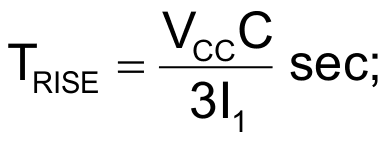

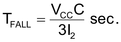

The expression for the rise time (TRISE) and fall time (TFALL) is the following:
If we make I1 and I2 dependent on VCC, we can eliminate the dependency on VCC, this makes the above expressions only depend on fixed parameters (more on that later).
For simulation purposes let’s assume that C = 100 nF, I1 = I2 = 2 mA and VCC = 9 V, therefore TRISE = TFALL = 150 µs. As shown in Figure 2, the circuit works properly.
