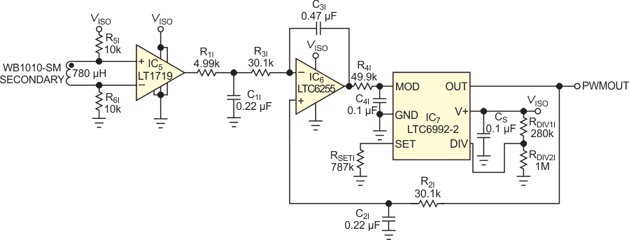

You add another voltage-controlled PWM IC to re-create the 1-kHz PWM signal on the isolated side (Figure 4). You use amplifier-integrator circuit IC6 to servo-control the duty cycle of IC7. Resistor RSETI programs IC7 for 1-kHz, 5- to 95%-duty-cycle operation. The circuit forces the 1-kHz output duty cycle to equal the 100-kHz input-signal duty cycle. Again, the supply voltage for comparator IC5 and the PWM device must be the same. If you want minimum duty-cycle ripple, set filter R2I and C2I to have a 500-msec time constant. Unfortunately, this approach would make the response time of the reconstructed output slow. You cannot use the anticipator circuit when you re-create the slow PWM signal because the slow signal is now the dependent variable in the circuit, and fast jumps in the feedback voltage would result in the loop’s continuously hunting and never settling to a final value. Use instead a 10-msec time-constant filter on the 1-kHz output to obtain a reasonable response time and then minimize duty-cycle ripple with an additional lowpass network comprising R4I and C4I.
This circuit re-creates the 1-kHz PWM control signal on the isolated side. It cannot use the anticipator circuit, but R4I and C4I provide extra lowpass filtering, helping to reduce output jitter.
Figure 4. This circuit re-creates the 1-kHz PWM control signal on the isolated side. It cannot use the anticipator circuit,
Note that the feedback signal for integrator IC1 in Figure 1 is on the negative pin and that the feedback signal to recreation integrator IC6 is on the positive pin. If you connect the fast-responding input signal to the positive input of IC6, it would cause a large overshoot in the duty cycle of the output signal and a long recovery time. You compensate for the polarity reversal by biasing the DIV pin of IC2.
Setting the DIV pin above VSUPPLY/2 programs the output-control polarity to change from 95 to 5% duty cycle with an increasing voltage applied to the MOD pin. An increase in the 100-kHz signal’s duty cycle now ramps down the MOD pin and increases the 1-kHz output signal’s duty cycle to match it.
