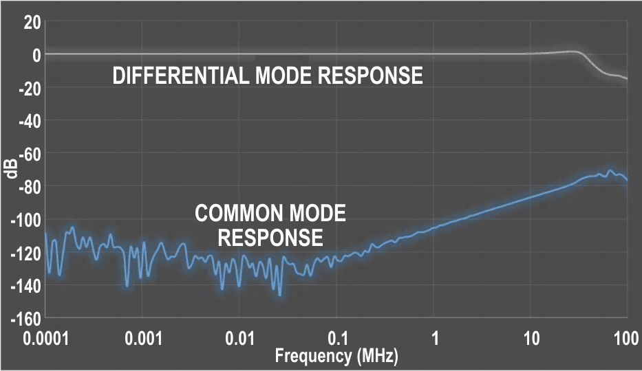

The differential-mode frequency response plot was taken by applying a differential input voltage at the two input terminals (IN+ and IN–).
| Figure 2. | Frequency response for differential and common mode signals. |
The gain resistors become part of the input resistance for the source. This provides better noise performance than the non-inverting configuration but limits the flexibility in setting the input impedance separately from the gain.
For the common-mode frequency response plot, the common-mode voltage is applied at two non-inverting input terminals (VREF) with IN+ and IN– tied together.
