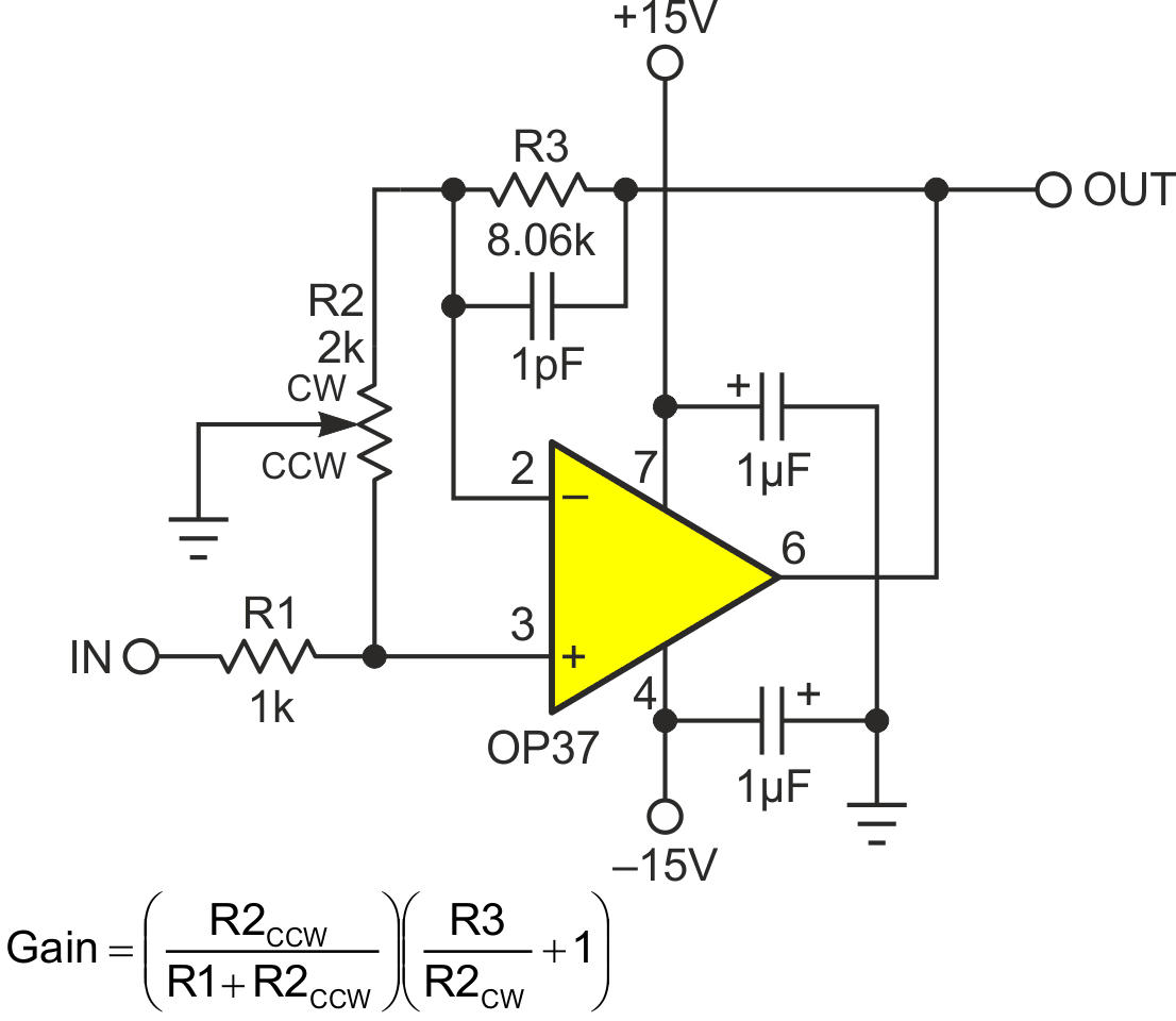

A short while back, I published a design idea (Ref. 1) that uses a single linear pot to control the gain of a high performance OP37 decompensated op-amp over an unusually wide (–30 dB to +60 dB) range.
Figure 1 shows the circuit.

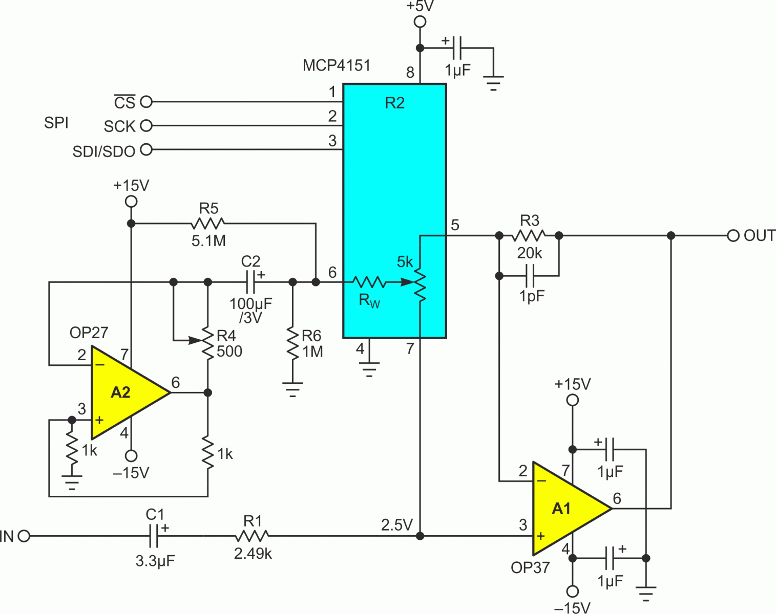

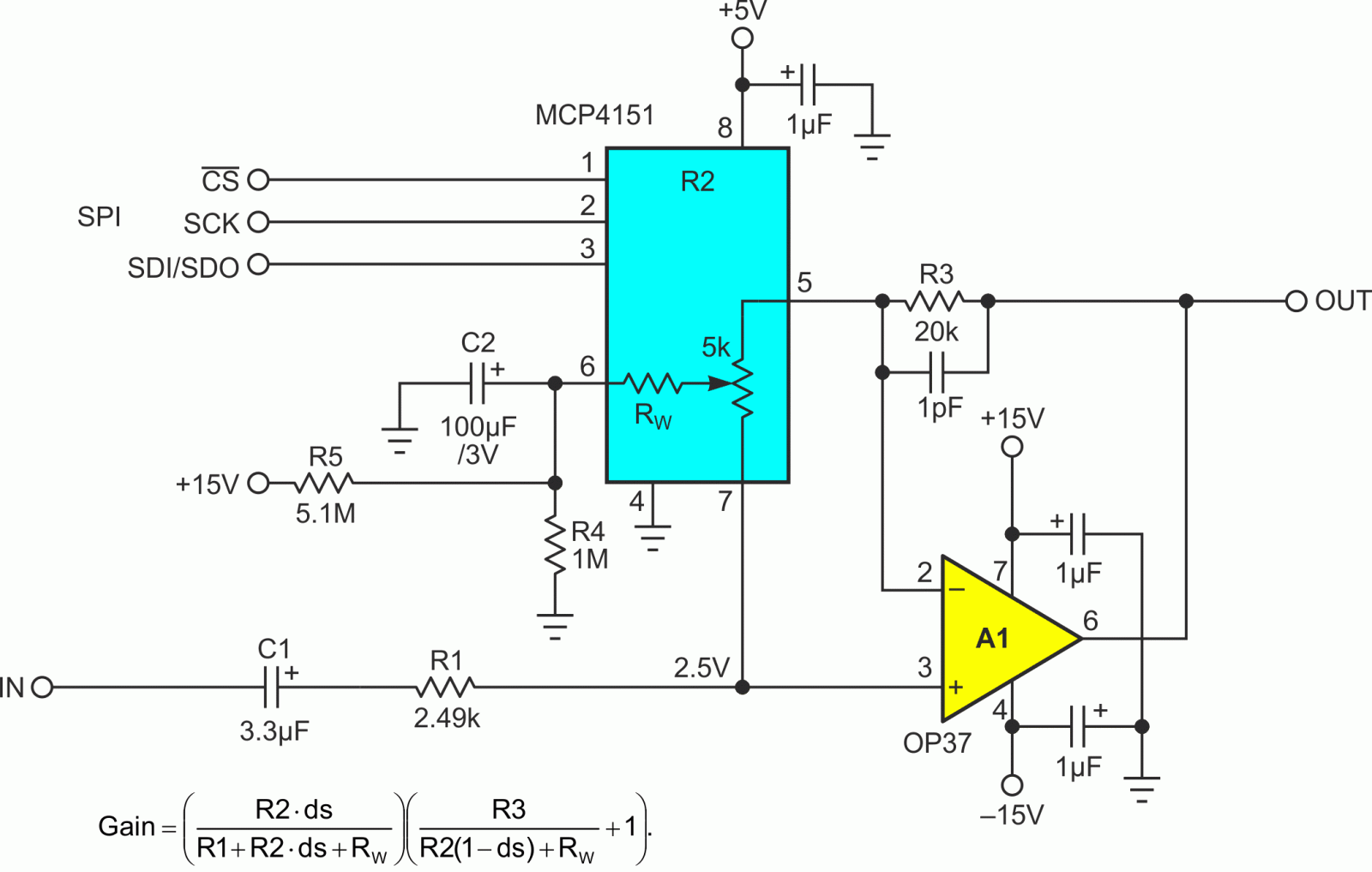

Recently I started wondering whether a digital pot (Dpot) would work in place of Figure 1’s mechanical R2. Figure 2 shows what seemed like a likely Dpot topology.
| Figure 2. | R2 has the same function as in Figure 1 with DC bias from R4R5C2 to accommodate bipolar signals. But what about RW wiper resistance effects? |
On closer inspection, it turned out not to be so very promising after all. This is due to wiper resistance interfering with the isolation of the two halves of R2 that made the original circuit work in the first place. Figure 3 shows the fix I eventually resorted to.
| Figure 3. | Positive and negative feedback loops around A2 combine to create active negative resistance = –R4. |
A2 and its surrounding network are the basis of the trick. They generate an active negative resistance effect that subtracts from RW and, if adjusted so R4 = RW, can theoretically (the engineer’s least favorite word) cancel it out completely.
A quick method for dialing out RW is to write the Dpot setting to zero, provide a ~1 V rms input, then trim R4 for output null.

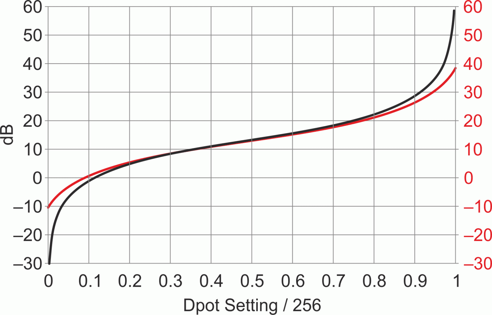

| Figure 4. | Red curve plots uncompensated RW (~150 Ω), note the 20 dB loss from both ends of the span. Black curve plots the case where RW is compensated with negative resistance (R4 = RW = 150). |
Figure 4’s red curve compares Figure 2’s behavior with an (uncompensated) RW = 150 Ω (plausible for the Microchip Dpot illustrated), while the black curve shows what happens if R4 = RW = 150 Ω. Compare it to the performance of the original (Figure 1) circuit using a mechanical pot as shown in Figure 5.
