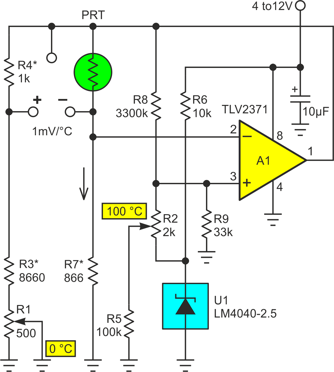

I thought Nick’s idea was so cool I just had to try and cobble up my own version of it. The initial effort is shown in Figure 1.
PRTD circuit shamelessly copies Nick C's idea for making an ordinary DMM into a precision digital thermometer.
Figure 1. PRTD circuit shamelessly copies Nick C’s idea for making an ordinary

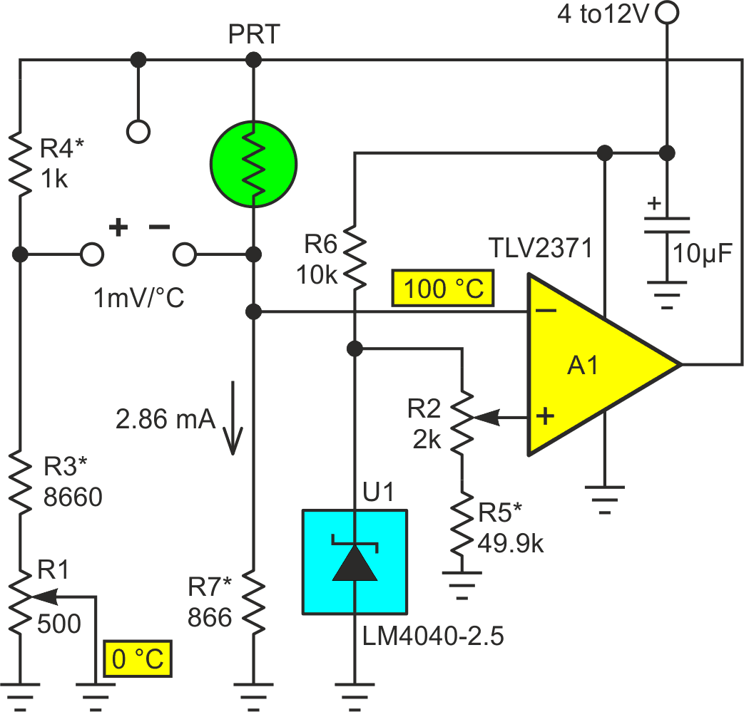

Figure 1’s circuit is conceptually identical to Nicks’s in putting the PRT into a basic bridge topology with constant current excitation of the PRT. It differs, however in one detail. Only the PRT half of the bridge is actively regulated with constant current while the other (zero adjust) half is just a passive voltage divider. This ploy reduces the parts count somewhat (saving two transistors, an op-amp, and maybe a resistor or two). But it doesn’t make the circuit work significantly worse or better. The calibration process is the same very-well-explained procedure in Nick’s DI as is achievable accuracy. I certainly won’t try to compete with Nick’s well written writeup in that regard.
In fact, I suppose you might legitimately ask if such a similar circuit really merits separate publication in the first place. Fortunately, this is not quite the end of our story.
Because of the 10% attenuation of the PRT signal inflicted by the passive side of my bridge, in order to duplicate Nick’s terrific feature of a 1 mV/°C direct-readout, I had to boost the PRT excitation current IPRT by that same 10% to make the bigger signal. So, I made
instead of the 2.597 mA used by Nick in his double-constant-current-source circuit. So far, so good.

All that’s required to utilize this effect to continuously and automatically fix the reading is the addition of R8 and R9 to generate the positive feedback provided in Figure 3. Now:
IPRT(T) = IPRT(0)[1 + 0.15(VPRT(T) – VPRT(0)].
The 40 mV of positive feedback via R8 to reference U1 increases PRT excitation current with increasing temperature and thus linearizes the temperature reading, making the thermometer accurate to ±0.1 °C.

Thus, as the readout voltage goes from 0 to 100 mV, the IPRT excitation current increases by the 0 to +1.5% needed to accurately linearize the reading. The residual error withFigure 3’s positive feedback can be seen in Figure 4.
