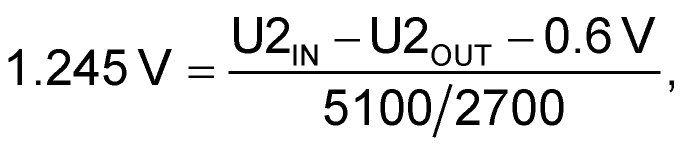

About that tracking preregulator thing: Control of U3 to maintain the 3 V of headroom required to hold U2 safe from dropout relies on Q1 acting as a simple differential amplifier. Q1 drives U3’s VFB voltage feedback pin to maintain VFB = 1.245 V. Therefore (if VBE = Q1’s base-emitter bias, typically ~0.6 V for IE = ~500 µA)

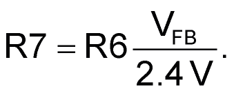

Note, if you want to use this circuit with a different preregulator with a different VFB, just adjust:
