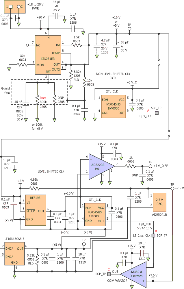

To set up the test, a special power-supply circuit was designed for the comparator as well as for a crystal-clock module with specified jitter. The power supply, clock, and comparator of the circuit (Fig. 1) were placed on a single printed circuit board (PCB) with ground plane. The board used a special scope probe-tip test point with a fitted, spiral ground wire, into which the probe’s ground-sleeve can fit. (This technique is often employed to reduce parasitic ringing and give a good return ground.) The rms jitter for this commercially available crystal-based clock module (CTS MXO45HS-3C-1M0000, 5 ps maximum) was better than the comparator could provide.

In the circuit (Fig. 2), using RSET, the main regulator (LT3081) can deliver +5 V to power either a basic clock, or +15 V to the level-shifted clock and comparator. The LT3081 was chosen as it is inherently stable with any type of load capacitance. Using this power configuration for flexibility, the non-level-shifted clock’s jitter can be measured, or the jitter of the level-shifted clock and comparator can be measured. A 5-V reference (REF195) is biased in series with a 5-V shunt reference (LT1634B-5).
Figure 2. | The LT3081 power supply is configurable for driving one of two possible circuits in the schematic diagram of the test board used to test comparator jitter. |
The crystal clock’s supply is powered with 5 V from the REF195.
The clock’s output will swing between 5 and 10 V with respect to ground. The level-shifted clock is applied to the comparator’s inverting terminal. The non-inverting comparator terminal is connected to +7.5 V, which is produced by placing another 2.5-V shunt reference (ADR5041B) in series with the 5-V shunt reference.
For test purposes, an instrumentation amplifier (AD8220) with unity gain is placed across the crystal clock’s power-supply pins to measure the supply’s stability during clock transitions. The integrated scope test points prevent significant overshoot and ringing on the high-speed edges of the signals from the level-shifted clock and comparator (Fig. 3).
