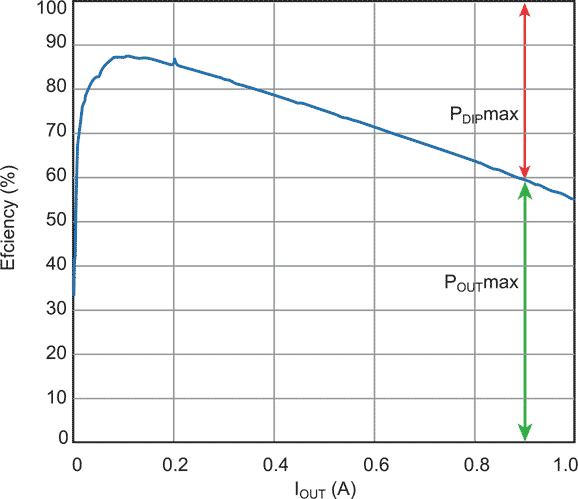

Using ultra-miniature power devices successfully in modern portable applications requires careful attention at both the component level and the board level to minimize the quantity of heat generated within the device and to ensure its efficient removal (Fig. 1).To minimize heat generation, device designers prioritize high-power conversion efficiency. For example, switching converters are preferred over linear operation for general-purpose applications such as point-of-load (POL) regulators. The best of these devices can achieve peak efficiencies from 95% to 97%.
Thermal Dissipation for DC-DC Conversion in portable Designs
Figure 1. Operating efficiency of the NCP1529 versus output current, at an 85°C ambient temperature, 2.7-V input, and 1.2-V output voltage.

Of course, the optimum application design should look to lower the potential for shut-down conditions to occur. One of the first steps in ensuring this is to have a clear understanding of operating efficiency.
Let us consider such a device supplying an IC core voltage of 1.2 V and drawing up to 900 mA. At a 0.9-A output current, the device is operating at 60% efficiency. Substituting these values into Equation 2 produces the following expression for worst-case power dissipation:
This dissipation is important to help optimize the thermal performance of the application.

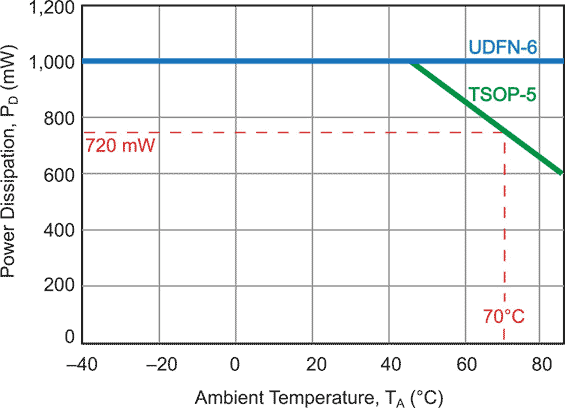

Remembering that the NCP1529 is available in TSOP-5 and µDFN-6 packages, the effect of each option on the operating envelope of the application can be quickly assessed. The table summarizes power dissipation, package thermal resistance, and calculated maximum ambient temperature for each case. It also shows that package selection is a key concern if the converter is to operate satisfactorily up to the maximum anticipated ambient temperature.
Another way to assess the effect of package thermal characteristics on performance is to inspect the power derating curves. Figure 2 shows the published curves for the NCP1529, detailing the maximum ambient temperature threshold versus power dissipation for the µDFN-6 and TSOP-5 packages.
Figure 2. Maximum ambient temperature threshold versus power dissipation for the NCP1529 with μDFN-6 and TSOP-5 packages.
Below 70°C, both packages can dissipate 720 mW and satisfy the worst-case requirement for this application. However, the improved dissipation capabilities of the µDFN-6 package allow a higher maximum temperature than can be sustained by an equivalent converter design based on the TSOP-5 variant. The performance advantage of the µDFN-6 package can be explained by its thermally enhanced structure, featuring an exposed metal pad that significantly reduces the thermal resistance from the die to the application PCB.

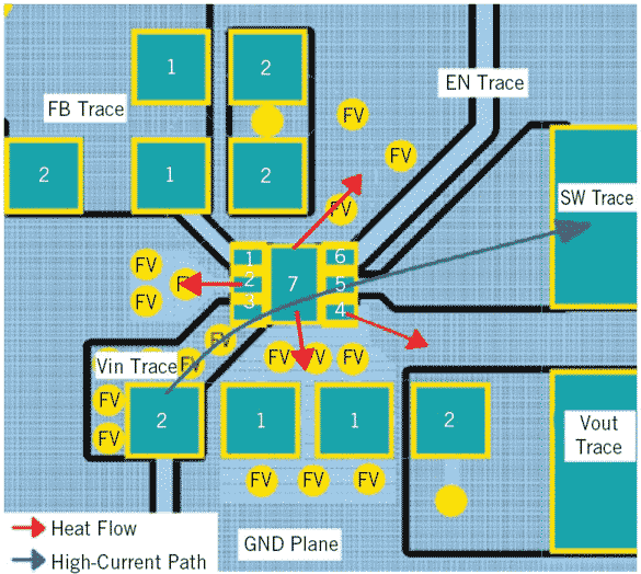

Thermal Design guidelines.
In each calculation, the value for TA assumes the best possible thermal resistance; i.e., the thermal resistance achieved when using the recommended board layout. As mentioned previously, board layout can have a profound effect on the thermal performance of the device and, consequently, the application. Designers using any dc-dc converter IC should consult documentation for the chosen part to be sure of achieving the expected performance when the design is implemented in hardware.
Thermal performance can be optimized using features such as thermal dissipation vias, maximizing key trace widths, making thermal connections to ground or power planes, or specifying a thermally enhanced PCB material, such as an insulated metal substrate. The thermal layout guidelines for the NCP1529 recommend enlarging the VIN trace and adding several vias to create multiple thermal connections to the power plane.
In addition, it is recommended to connect the regulator’s ground pin to the PCB top plane. The top, bottom, and ground planes should be connected using free vias to increase the effective size of the radiator, and these should be located as close as possible—underneath is ideal—to the exposed pad when using the µDFN-6 package. The µDFN-6 exposed pad must be correctly soldered to the main radiator of the PCB.
Of course, the designer must also bear in mind the effect of board layout on the electrical performance of the converter. Optimum thermal layout should complement features such as large traces for high-current paths, as well as separate power and ground planes, which help to maximize noise immunity and loop stability of the regulator.
Figure 3 shows the recommended pad layout when using the NCP1529 in µDFN-6 package, accounting for electrical and thermal considerations. The red arrows indicate the flow of thermal energy from the package toward ambient.

To implement high-performance dc-dc converters within the exacting space constraints of today’s mobile products, designers must pay careful attention to operating conditions, power dissipation, component performance, and thermal design. The latest smalloutline package technologies with enhanced thermal features allow higher dissipation than more established power packages. Using these in combination with best-practice thermal design at the board level allows designers of portable systems to achieve reliable high current designs within compact dimensions.
