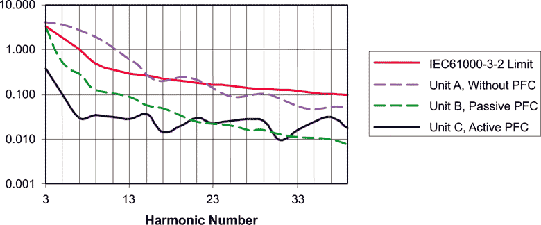

Figure 1. By comparison, power supply with active PFC controller outperforms passive PFC to exceed the IEC61000-3-2 specifications for harmonics on the mains line. (Courtesy of ON Semiconductor.)
Figure 1 shows the input harmonics for three different 250 W PC power supplies, compared with the limits according to EN/IEC61000-3-2 specifications for Class D devices. The harmonic amplitudes are proportioned to the input power of these devices. The performance of the passive PFC, as shown in this graph, just barely complies with the limit for the third harmonic. The unit with active PFC meets and beats the IEC61000-3-2 specs.

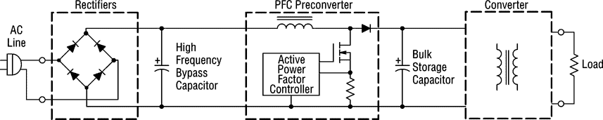

Besides performance, the rising cost of copper and magnetic core material, coupled with the falling cost of semiconductors, has tilted the balance in favor of active PFC solutions, even in the most cost-sensitive consumer equipments. In the following scheme (Figure 2), the active PFC circuit is placed between the input rectifier and the storage capacitor, followed by the DC/DC converter. The PFC IC with associated circuitry shapes the input current to match the input voltage waveform and achieve PF that is 0.9 and higher.
Understanding Different Power Factor Correction Techniques for AC/DC Front-ends
Figure 2. The active PFC controller circuit is placed between the input rectifier and the storage capacitor. (Courtesy of ON Semiconductor.)
