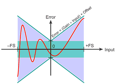

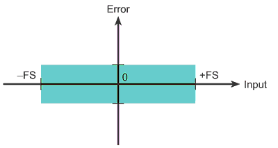

Accuracy. Keithley normally expresses its accuracy specifications in two parts, namely as a proportion of the value being measured, and a proportion of the scale that the measurement is on, for example: ± (gain error + offset error). This can be expressed as ± (% reading + % range) or ± (ppm of reading + ppm of range). The range in Figure 1 is represented by FS or «full scale.» For example, the specification for Keithley’s Model 2000 6.-digit multimeter, when measuring voltage on the 1 V range, states an accuracy of 30 ppm of the reading + 7ppm of range. The green box represents the offset error, which is expressed either as a percentage of the range or ppm of the range. Figure 2 illustrates the gain error, which is expressed either as a % of the reading or ppm of the reading. When carrying out a reading, we can expect the error to be anywhere within the purple and green areas of the graph. Accuracy specs for high-quality measurement devices can be given for 24 hours, 90 days, one year, two years, or even five years from the time of last calibration. Basic accuracy specs often assume usage within 90 days of calibration.

Instrumentation error. Some measurement errors are a result of the instrument itself. As we have already discussed, instrument error or accuracy specifications always require two components: a proportion of the measured value, sometimes called gain error, and an offset value specified as a portion of full range. Let’s look at the different instrument specifications for measuring the same value. In this example, we are trying to measure 0.5 V on the 2 V range, using a lesser quality DMM. Using the specifications, we can see that the uncertainty, or accuracy, will be ± 350 µV. In abbreviated specs, frequently only the gain error is provided. The offset error, however, may be the most significant factor when measuring values at the low end of the range.

Accuracy = ±(% reading + % range) = ±(gain error + offset error)
For example, DMM 2V range:
Accuracy = ±(0.03% of reading + 0.01% range)
For a 0.5 V input:
Uncertainty = ±(0.03% . 0.5 V + 0.01% . 2.0 V = ±(0.00015 V + 0.00020 V) = ±350 µV
Reading = 0.49965 to 0.50035
In the next example, we have the same scenario, i.e., trying to measure 0.5 V using the 2 V range, but we are now using a better quality DMM. The example has better specifications on the 2 V range, and the uncertainty is now just ±35 µV.
DMM, 6½-digit, 2 V range (2.000000)
Accuracy = ±(0.003% reading + 0.001% range) =
= ±(30ppm readings + 10ppm range) = ±(0.003% reading + 20 counts)
Uncertainty  0.5 V = ±(0.000015 + 0.000020) = ±0.000035 V = ±35 µV
