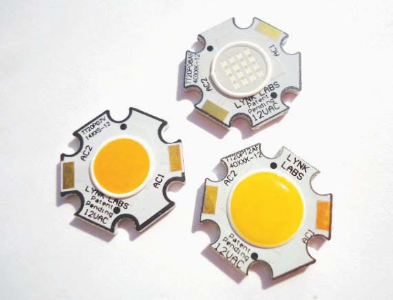

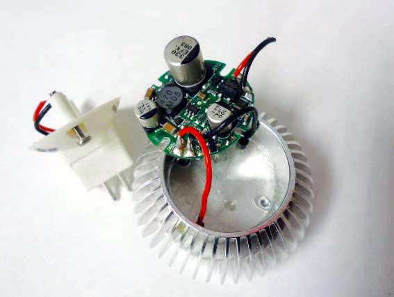

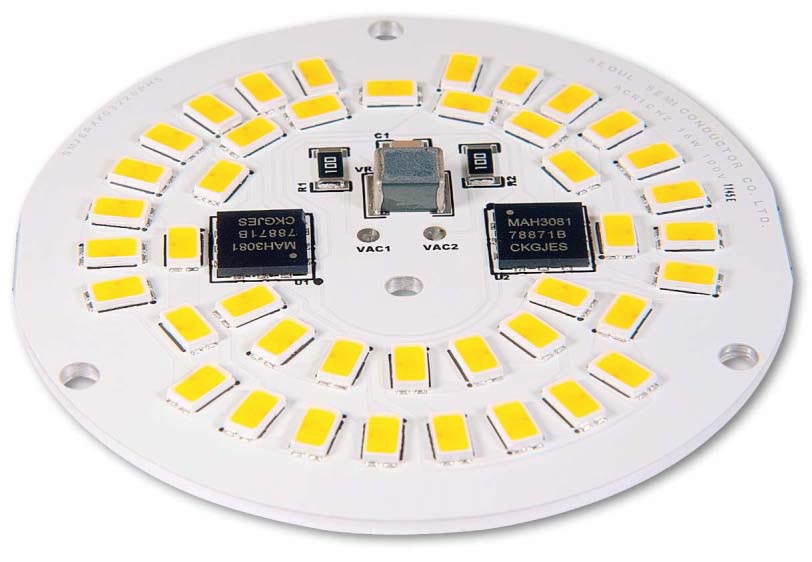

Fig. 2 compares a DC-LED approach with its electronics to two AC-LED approaches. With a diameter of only 2 inches and length of less than 2 inches, the MR16 lamp or GU10, the latter of which connects directly to line voltage, are prime candidates for the AC module.

Figure. 2a. An un-assembled MR16 lamp with DC-LEDs. Figure. 2b. Lynk Labs 12V AC-LED COB packages. Figure. 2c. Seoul Semiconductor 120V AC-LED assembly uses 4W to achieve 35W-equivalent MR16.
