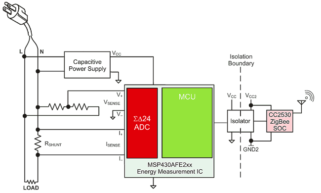

Components of energy measurement
An energy measurement system requires voltage and current sensors, an AFE to interface with these sensors and an MCU to perform energy measurement calculations. The energy measurement results can be displayed on an LCD screen or sent over the serial bus to another device for wireless communication as shown in Figure 2.

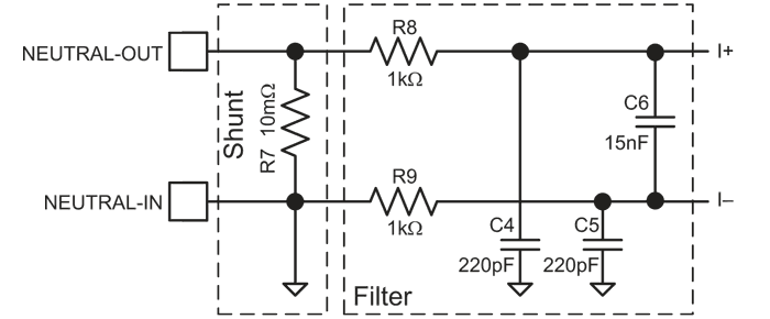

The choice of current sensors depends on the type of incoming mains that the appliance uses. In the U.S., appliances such as refrigerators and washing machines run on single-phase 120 VAC, whereas high-power appliances such as clothes dryers and electric cooking ranges operate on split-phase 240 VAC. For single-phase applications, a low-value shunt resistor can be placed in the neutral line (Figure 4) and the voltage drop across the shunt can be measured to calculate the current. The value of the shunt resistor is determined by the range of load currents, gain settings of the ADC and the power dissipation at the sensors. Shunt resistors are low cost and easy to use, but they do not provide electrical isolation. For appliances such as clothes dryers and cooking ranges that use a split-phase supply, current transformers must be used on each of the two live wires. Current transformers provide electrical isolation, but cost more than shunts.
| Figure 4. | Current-sensing circuit for the MSP430AFE2xx energy measurement IC. |
The sensing stage is followed by passive interface circuitry that further conditions the input signals before being fed into the ADC. This circuitry includes a filter to remove spurious wideband noise that can lead to inaccurate measurements. For single-phase appliances such as refrigerators, two ADCs are needed: one to measure the voltage and another to measure the current. For clothes dryers and cooking ranges, four ADCs are needed to measure two voltages and two currents. ADCs with 16-bit or 24-bit resolution and simultaneous sampling capability can be used to generate accurate energy-measurement results.

Once energy measurement results have been calculated, they can be displayed on an LCD on the sub-meter itself or on a remote terminal. The MCU can be interfaced with LCD drivers or wireless communication modules via serial communication interfaces. If non-isolating sensors such as shunts and voltage dividers are used or if the AFE and MCU are referenced to the mains, it is critical to isolate any connection to other devices or systems that use a different reference voltage. Optocouplers or capacitive isolation ICs can be used to implement this isolation.
An energy measurement system using low-power components can be powered using a simple capacitive power supply. However, a capacitive power supply does not provide enough current to drive RF transceivers. Sub-meters that use Wi-Fi™ or ZigBee® to transmit energy consumption data will need an additional NPN output buffer or a transformer and switching-based power supply to power the RF transceivers.

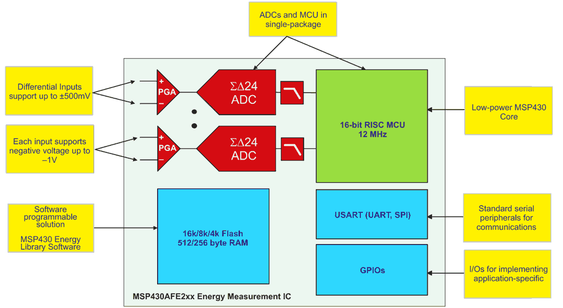

The MSP430AFE2xx energy measurement IC (Figire 5) integrates multiple 24-bit sigma-delta ADCs, programmable gain amplifiers and a 16-bit MCU in a single package. This device is accompanied by TI’s MSP430™ MCU Energy Library [4] software to implement energy-measurement calculations.
| Figure 5. | Features of the MSP430AFE2xx for energy-measurement applications. |
Developers will experience the following key features and benefits when using the MSP430AFE2xx energy measurement IC for sub-meters:
High level of integration
The MSP430AFE2xx integrates several components required for energy measurement including the ADCs and the MCU. This enables low-cost and small-footprint sub-meter designs that use a minimum number of components. In addition to energy measurement, the MSP430AFE2xx MCU can also be used for running other small applications as needed.
Multiple 24-bit sigma-delta ADCs
Each of the three ADCs supports a differential input voltage of ±500 mV, so outputs from the current sensor can be fed directly to the ADC without the need for level shifting. The ADC inputs also support a negative input voltage of up to –1 V which allows the divided down voltage signal from the AC mains to be also interfaced directly to the ADC without additional level shifting.
The MSP430AFE2xx offers up to three sigma-delta ADCs with 24-bit resolution. These ADCs are capable of providing utility grade (<0.1 percent) accuracy over a wide range of load currents. The simultaneous sampling feature of the ADCs eliminates inherent delay between the current and voltage samples and eliminates the need for software compensation, an anomaly of the sequential sampling approach.
