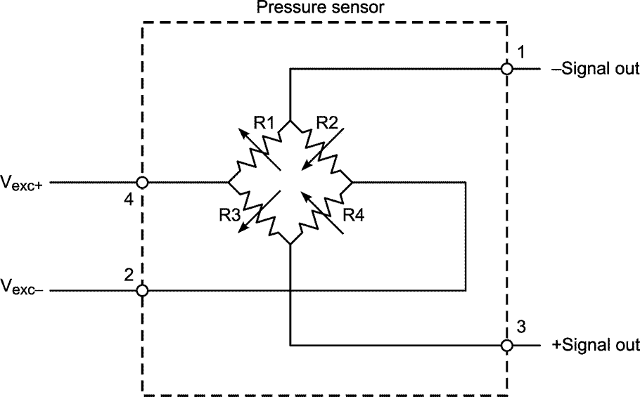

The pressure sensor has a thin silicon membrane covering a sealed cavity, with four piezo-resistive elements fabricated on the surface (Fig. 1). When the ambient pressure differs from the pressure inside the cavity, the membrane deforms, changing the resistance of these elements. The pressure sensor typically connects the piezo-resistive elements in a Wheatstone bridge with resistors R1 and R4 showing increased resistance with rising ambient pressure and resistors R2 and R3 showing decreased resistance (Fig. 2). Amplifiers integrated into the silicon provide the pressure readout.
Measure Laser Power With A Modified MEMS Pressure Sensor
Figure 2. The MEMS sensor’s piezo-resistive elements connect in a Wheatstone bridge to provide a signal proportional to the applied pressure.
The change in element resistance RP is a function of both pressure and temperature, however, with
RP = R(T)[1 ± S(T) P],
where R(T) is the piezo-resistor’s nominal value at a reference pressure, S(T) is the resistor’s sensitivity to changes in pressure, and P is the applied pressure on the membrane. As a result, commercial piezo-resistive pressure sensors must incorporate temperature compensation circuits to ensure an accurate pressure measurement.

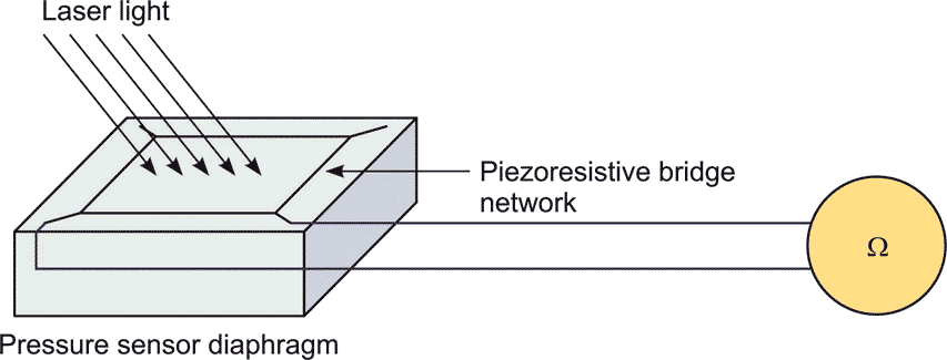

We modified a pressure sensor that offered 100-psi range with temperature compensation up to 60°C by removing the top casing and connecting a thin pair of leads across one piezo-resistive element of the bridge, bypassing the temperature compensation circuits (Fig. 3). We resealed the case with a protective cover and exposed the sensor membrane to a variable power laser source (λ = 488 nm).
Figure 3. Connecting leads across one element of the sensor’s bridge allowed measurement of its resistance while bypassing the sensor’s built-in temperature-compensating circuits.

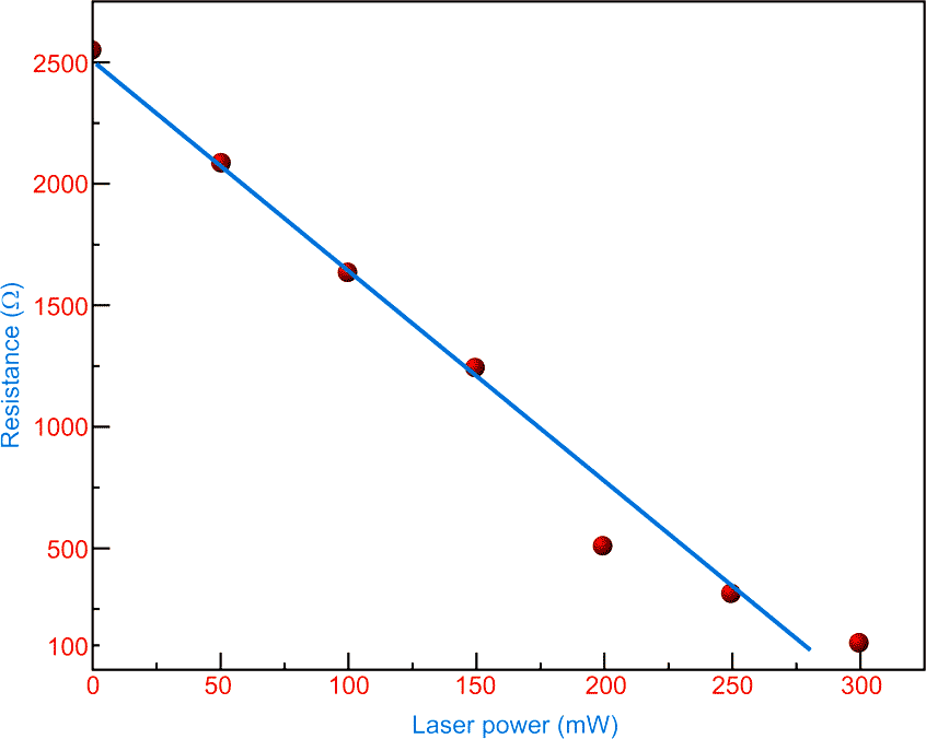

Laser exposure caused the resistance of the selected element to change, predominantly due to heating rather than membrane deflection. Calibration then allowed use of the element’s resistance as a direct measure of laser power. The results demonstrate that the element showed excellent linearity while measuring laser power between 0 mW and 300 mW (Fig. 4).
Figure 4. Exposing the modified pressure sensor to laser energy created a temperature-induced change in the piezo-resistive element’s resistance that corresponded directly to laser power.
